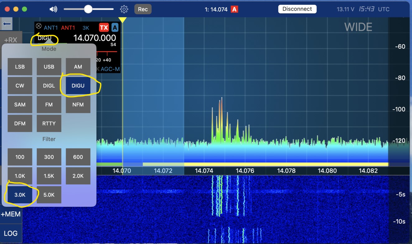

- On the Mac: Open a slice at a suitable frequency on the Mac and configure it for digital transmissions (Mode = DIGU).

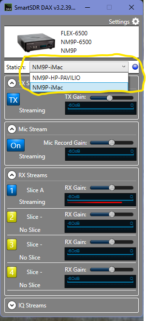

- On the Local Windows Computer: Start DAX and CAT. (It is not necessary to start SSDR for Windows)
- Start your digital program (like WSJT-X) on the Windows PC.

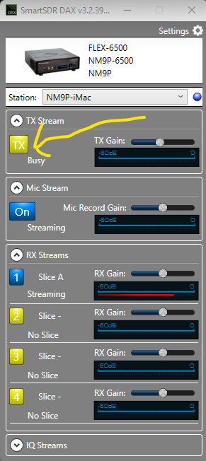

- In both DAX and CAT on the Windows PC: Select the Mac "station" in the "Station:" pull-downs for both DAX and CAT. (see picture)

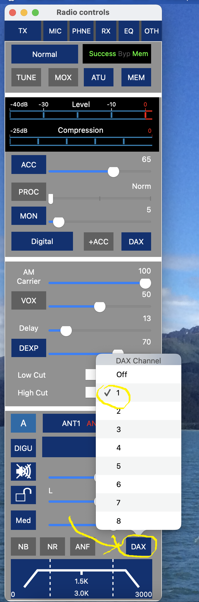

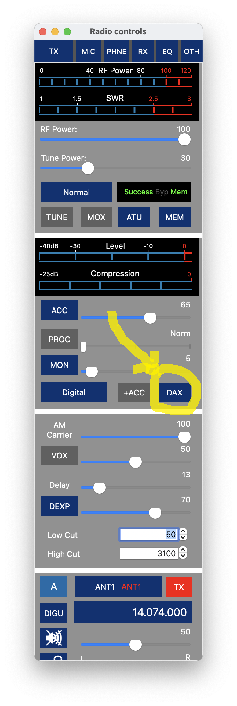

- In the SSDR for Mac Radio Controls Window: Select the DAX Receive Pull-Down and select the DAX channel you wish to use. (I have selected the DAX RX 1 channel.
- Enable the DAX TX button in the same Mac Radio Controls window

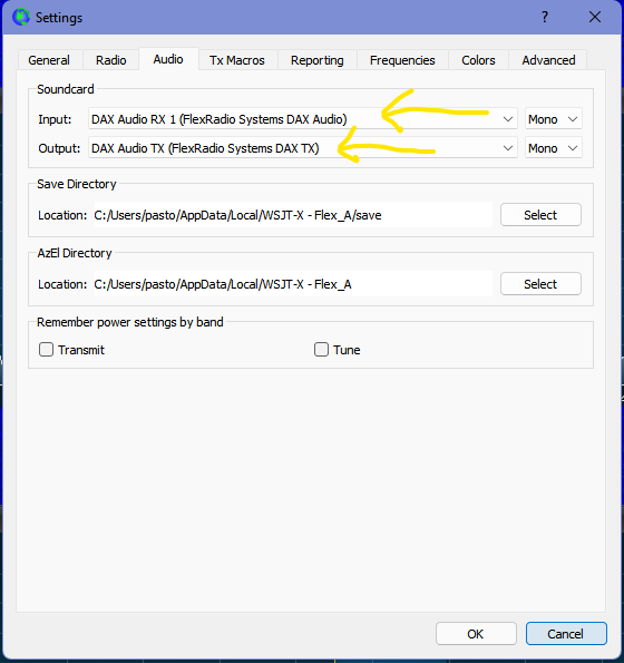

- Select the appropriate Audio Input and Output devices in the Soundcard section of the digital software. - For WSJT-X, using DAX Audio RX 1 and the DAX Audio TX channels, it would look like this:

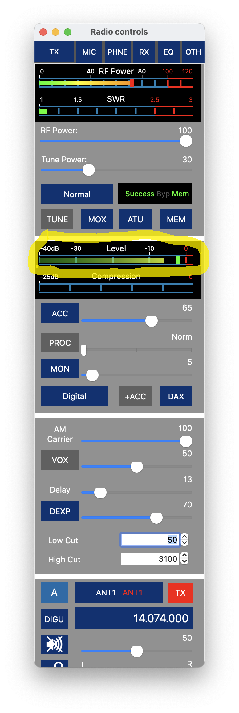

- Set the DAX TX stream level slider (in the SSDR for Windows DAX control panel) for proper audio output levels on the SSDR-Mac LEVEL Meter on the Radio Controls panel. This can usually be reached with the setting of between 44 and 46 on the DAX TX level slider The Peak indicator should be between -1 and about -3 on the LEVEL meter.
This picture shows The Peak Level Meter (The small line) at -3.

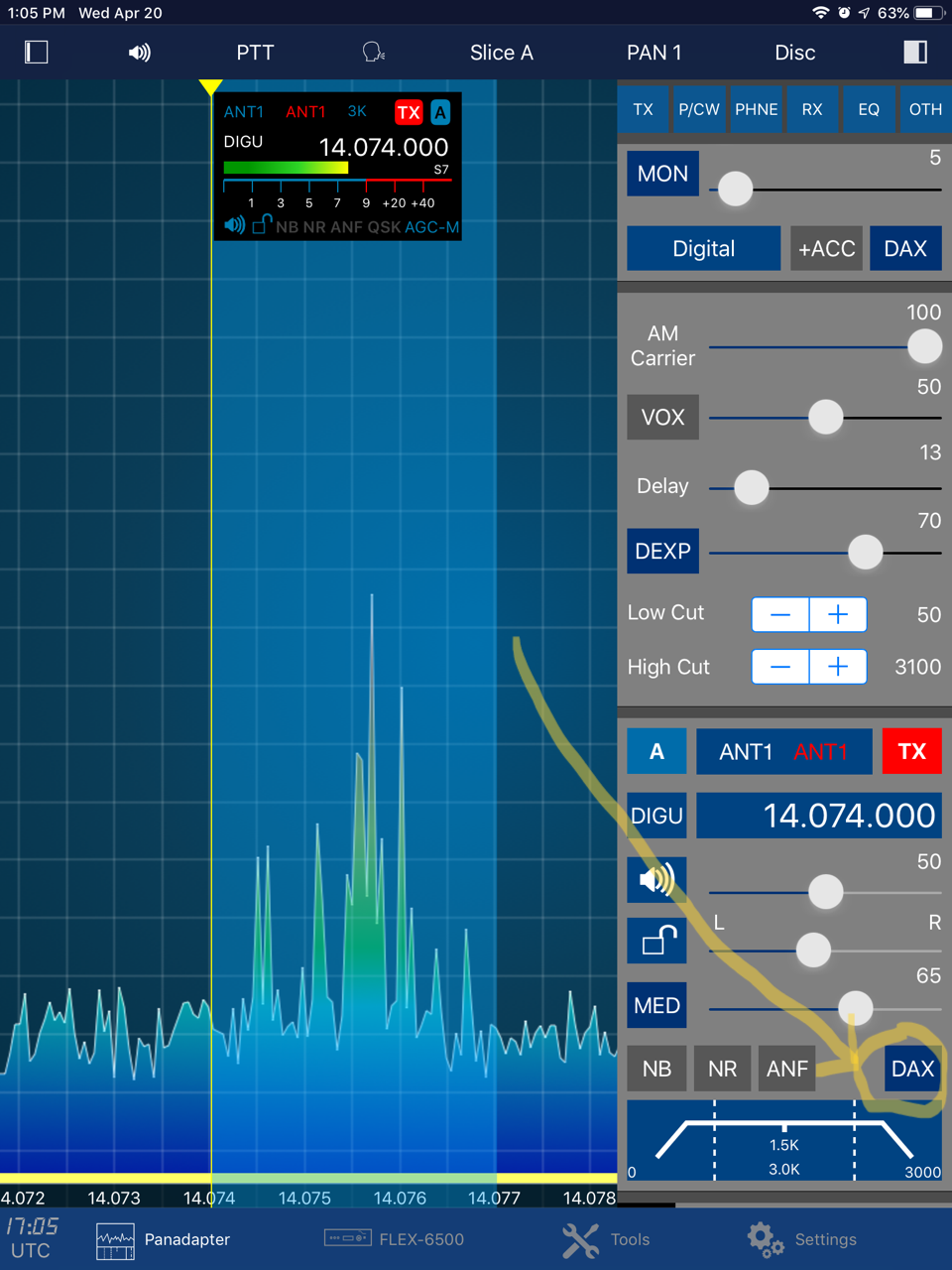

If you are using SmartSDR for IOS, the only changes needed are:
- Select the IOS Device as the "Station" in DAX and CAT. (Rather than the Mac)

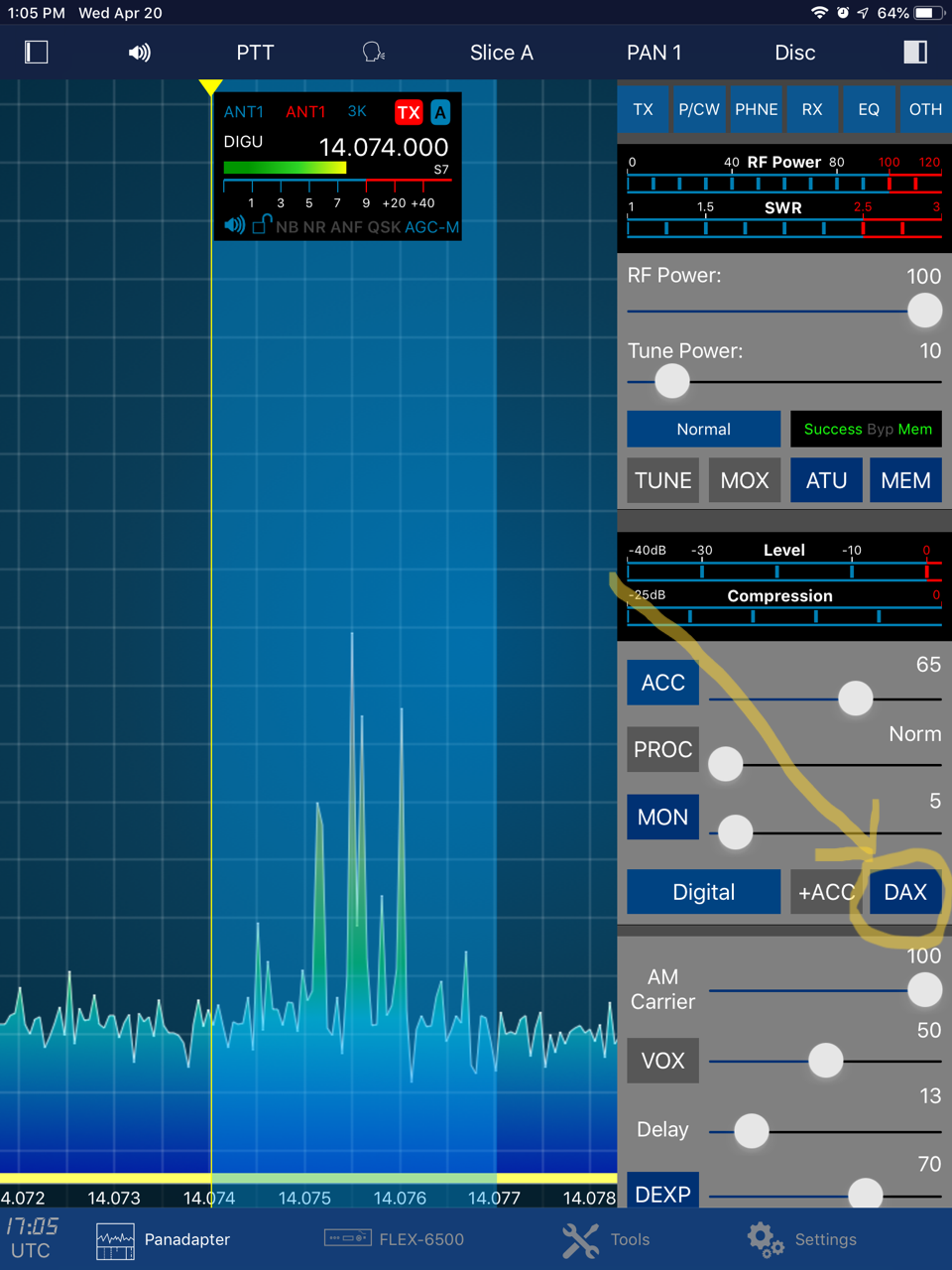

- Enable the DAX TX on the iPad:

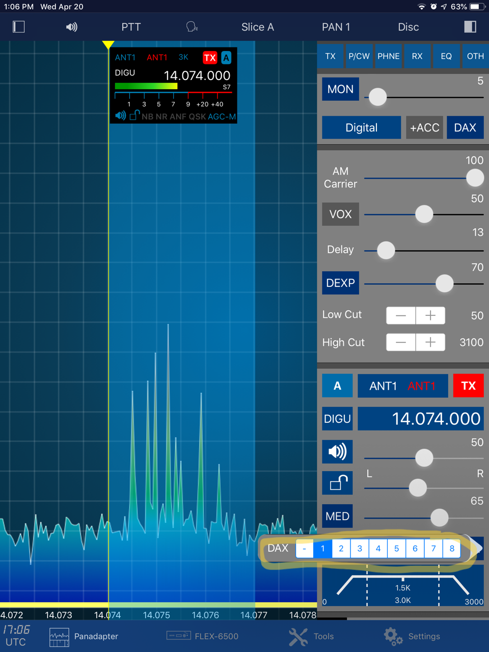

- Enable the DAX RX Channel on the iPad:
This should get your WSJT-X running with the slice that is controlled by SSDR for IOS on your iPad.

If the DAX Streaming indicator in the DAX Control Panel says "BUSY," try toggling the Button OFF and Back ON to initialize the TX Stream to the SSDR-Mac software.
