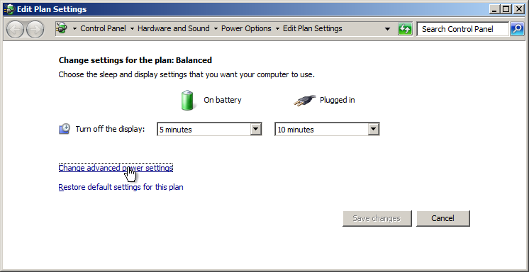

Click the Start button and type "edit power plan" in the Windows Search box.

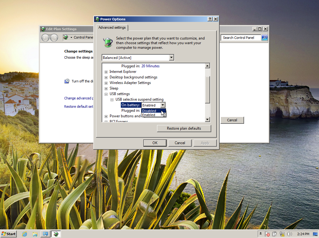

Click Change advanced power settings then scroll down to USB settings and click the little plus next to USB selective suspend setting to expand the options.
Set both the On battery and Plugged in settings to Disabled then click OK to apply changes.
