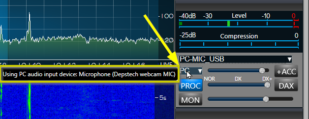

- You must have that microphone selected as the Default Recording Input Device in Windows Sound Manager. (Hover your mouse over the PC Mic indicator in SmartSDR. It will open a pop-up box that tells which audio device is assigned in Windows Sound System. In this example, my webcam's built-in mic is being used.)
- Select the "PC" Mic from the Mic Input Selection Pull-down menu in the "Radio Controls" Panel, "P/CW" sub-panel:

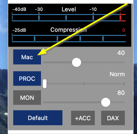

- When using SmartSDR for MAC, you need to select "Mac" rather than "PC" in the Microphone pull-down menu in the "Radio Controls > "MIC" Sub-Panel."

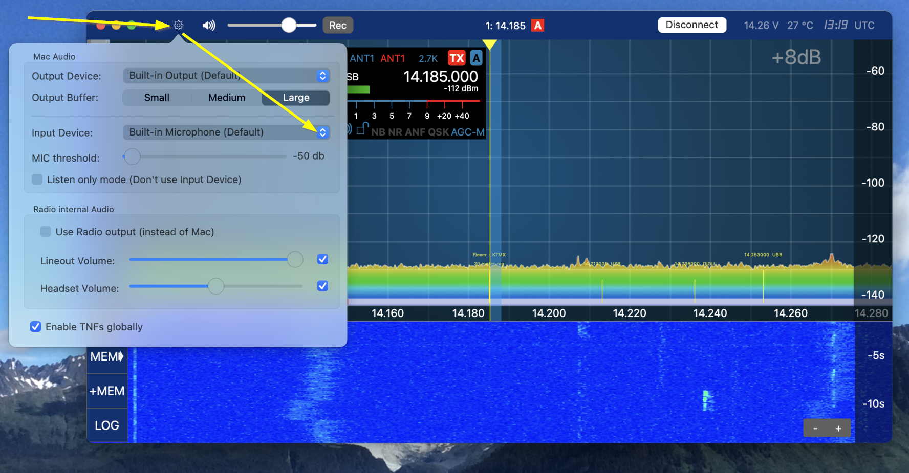

- In SmartSDR for Mac, select the Mac's Mic Input by clicking on the "Gear" Icon at the top of the main SmartSDR Screen.
