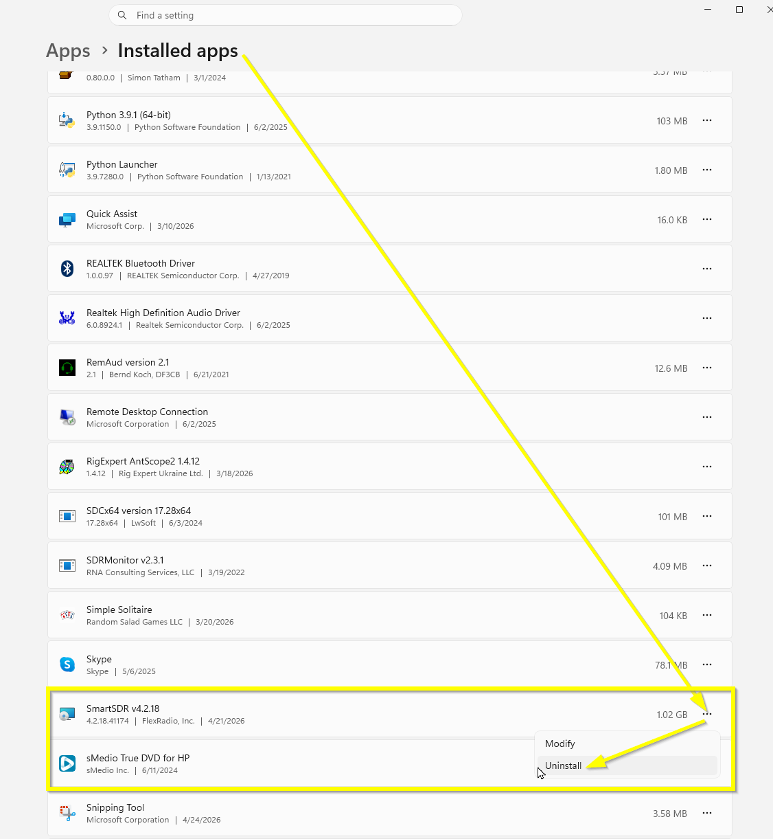

SmartSDR v4.2.18 introduced a new MSI Installer that requires a different procedure to uninstall.
1) Right-Click on the "Window Icon" (Start Menu Button)
2) Select "Installed Apps"
3) Scroll down to "SmartSDR v4.2.18 (or the current version you wish to uninstall)
4) Click on the ". . ." on the right-hand side of the column.
5) Click on "Uninstall"
It will give you a message "This app and its related info will be uninstalled."
Click "Uninstall"
This will uninstall SmartSDR v4.2.18, DAX and CAT.
6) Reboot the Computer.
