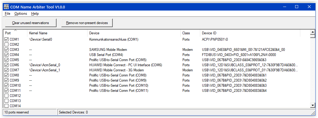

To fix the condition to unmark unused ports that are in use, you have to modify the Windows Registry, which we do not recommend doing. There is a program that you can use to do this for you and remove most of the risk associated with modifying the Registry called COM Name Arbiter Setter V1.0 (http://www.uwe-sieber.de/misc_tools_e.html#arbiter). It has to be run as an Administrator to modify the registry.

When you run it, click on the Clear unused Reservations and Remove non-present devices buttons to clean up COM port allocations.
