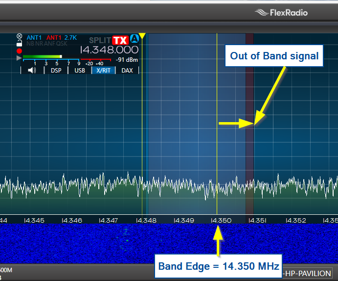

What does this look like on SmartSDR for Windows?
In this visual illustration, the radio's dial frequency is set to 14.348.000 MHz.
The thin yellow line to the right of the dial frequency denotes the band edge frequency of 14.350.000 MHz.
The BLUE Bar represents the Receive Filter Bandwidth. (2.7 KHz wide - set from 100 Hz to 2800 Hz)
The Dark RED to the right of the slice RX Filter bar represents the part of the Transmit Bandwidth that is wider than the Receive Filter. Your radio will not normally show this red band, but it has been made visible for this illustration.
The TX Bandwidth "High-Cut" is set to 3000 Hz (3KHz) wide.
RF emissions to the right of the Band edge are "Out of Band" and any RF transmission will not be permitted.

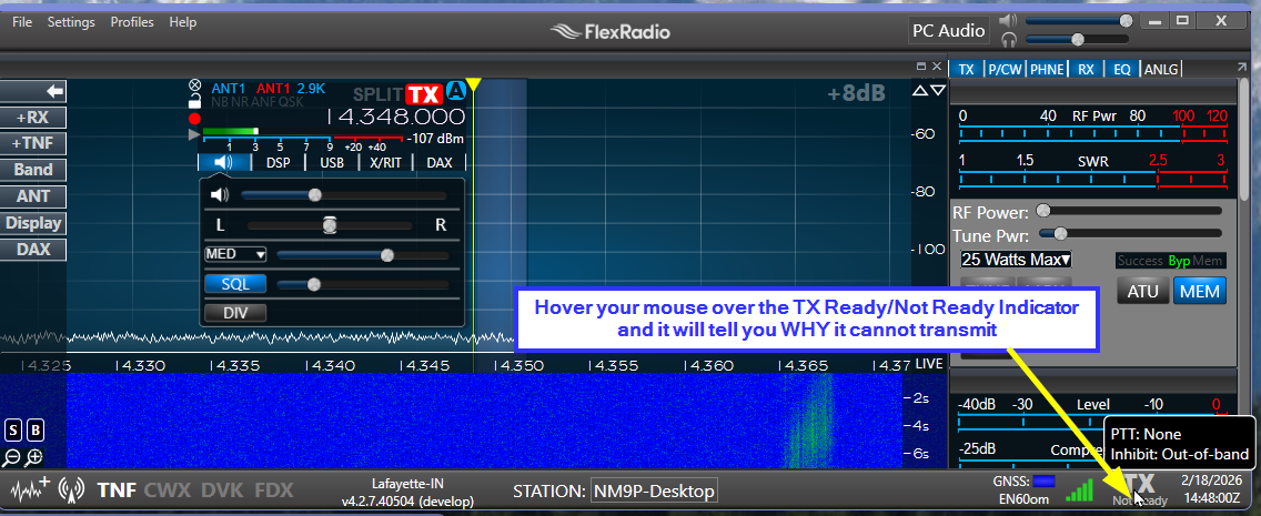

SmartSDR Will Warn You of this Condition:
- If the radio senses an issue that should inhibit transmission, it will indicate "TX Not Ready" in the "TX Ready / Not Ready" indicator.
- Hover your mouse over the TX Ready / TX Not Ready indicator, and a pop-up message will tell you why the radio cannot transmit.
- In this picture, the indicator says: "Inhibit: Out Of Band" because the USB Transmit Bandwidth, plus the VFO Dial Frequency of 14348, puts the RF transmission outside of the amateur radio band limit. So the "Transmit Inhibit" is engaged, preventing the radio from transmitting.
