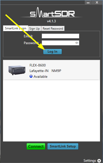

How to Log In to an Existing SmartLink Account:
To log in to an existing SmartLink Account, follow steps A and B above to navigate to your "Radio Chooser" Screen. and open the SmartLink Log-In window:
1. Enter the email address you used to create the intended SmartLink account. Hit the "TAB" Key.
2. Enter the Password you used when you created the SmartLink Account.
3. Hit the "Show/Hide" button to see the Password to check for accuracy.
(Many Log-in problems are caused by typos or Capitalization errors.)
4. Click the "Log In" button to log in to your existing SmartLink Account.
NOTE: For SmartSDR v3.8 and following:
Enter your SmartLink Email and password in the appropriate boxes.
Then click the "LOG IN" button

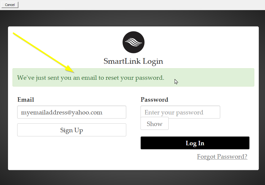

If all else fails, you can reset your password:
How to Reset your SmartLink Password:
If it becomes necessary to change or reset your SmartLink Password:
Navigate to the "Log In" Window.
1. Enter your SmartLink Account Email Address and hit the "TAB" Key.
2. Hit the "Forgot Password" link.
NOTE: For SmartSDR v3.8 and later, the screen looks like this:
Click on the "Reset Password" tab
Click on the "Reset Password Button"
The SmartLink Log-in will respond with a message in green:
"We've just sent you an email to reset your password."
NOTE: For SmartSDR v3.8 and following, the response will look like this:
Check your email account.
If you receive the "reset" email. Please follow the instructions in the email to reset your SmartLink password.
Then log back into your SmartLink Account using your new password.
