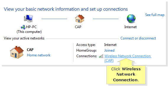

Windows Vista/Win 7
- Click on the Wireless icon on the task bar or at the bottom-right corner of your screen and select Open Network and Sharing Center.
- On the Network and Sharing Center window, click the Wireless Network Connection option.
The Wireless Network Connection Status window will appear showing your computer’s wireless connection details. The Speed section indicates the connection speed between the wireless adapter and the router.
