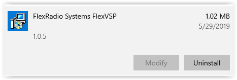

Scroll down to the FlexRadio Systems FlexVSP program entry and click on it.
Click on the ellipsis (...) and then click on Uninstall option.
You will be prompted, "This app and its related info will be uninstalled". Click on the Uninstall option.

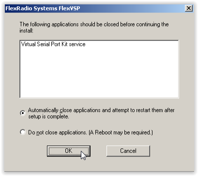

If you receive a prompt to “Automatically close applications and attempt to restart them after setup is complete”, click on OK to continue. See image below.

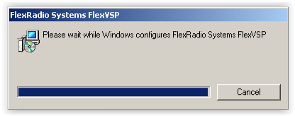

A progress dialog box will be displayed, as shown below, as the FlexRadio Systems FlexVSP driver is being uninstalled.
