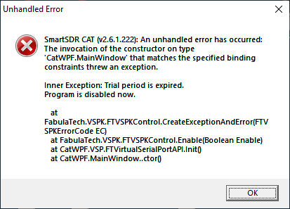

If you start up SmartSDR CAT and you receive an error that the "Inner Exception: Trial Period has Expired. Program is disabled now" error (see image below), follow this procedure to correct the issue. This error occurs because a Windows 10 update uninstalled and reinstalled the FlexVSP driver, and the reinstallation failed.
- Run the HelpDesk procedure, How to Manually Uninstall the FlexVSP Driver.
- After you reboot your PC, run the HelpDesk procedure, How to Manually Install the FlexVSP Drivers.
