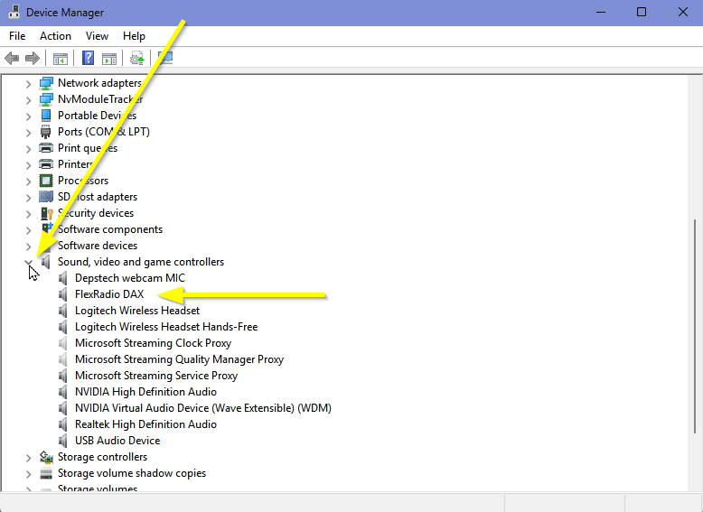

Verifying FlexRadio DAX Driver Using Windows Device Manager
Accessing Device Manager
Press the Windows key, type Device Manager, and select it from the results.
In Device Manager, click View > Show Hidden Devices (ensure it has a check mark).
Expand Sound, Video, and Game Controllers.
Take a screen capture of this expanded list and send it to me.
