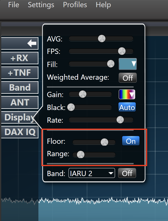

Setting Noise Floor Range in SmartSDR for Windows
- Open the Display menu on the left-hand side of SmartSDR.
- Set the Floor slider to the noise floor position you want, then click the button beside it to turn Relative Noise Floor Scaling on.
- Adjust Range, on the row below Floor.

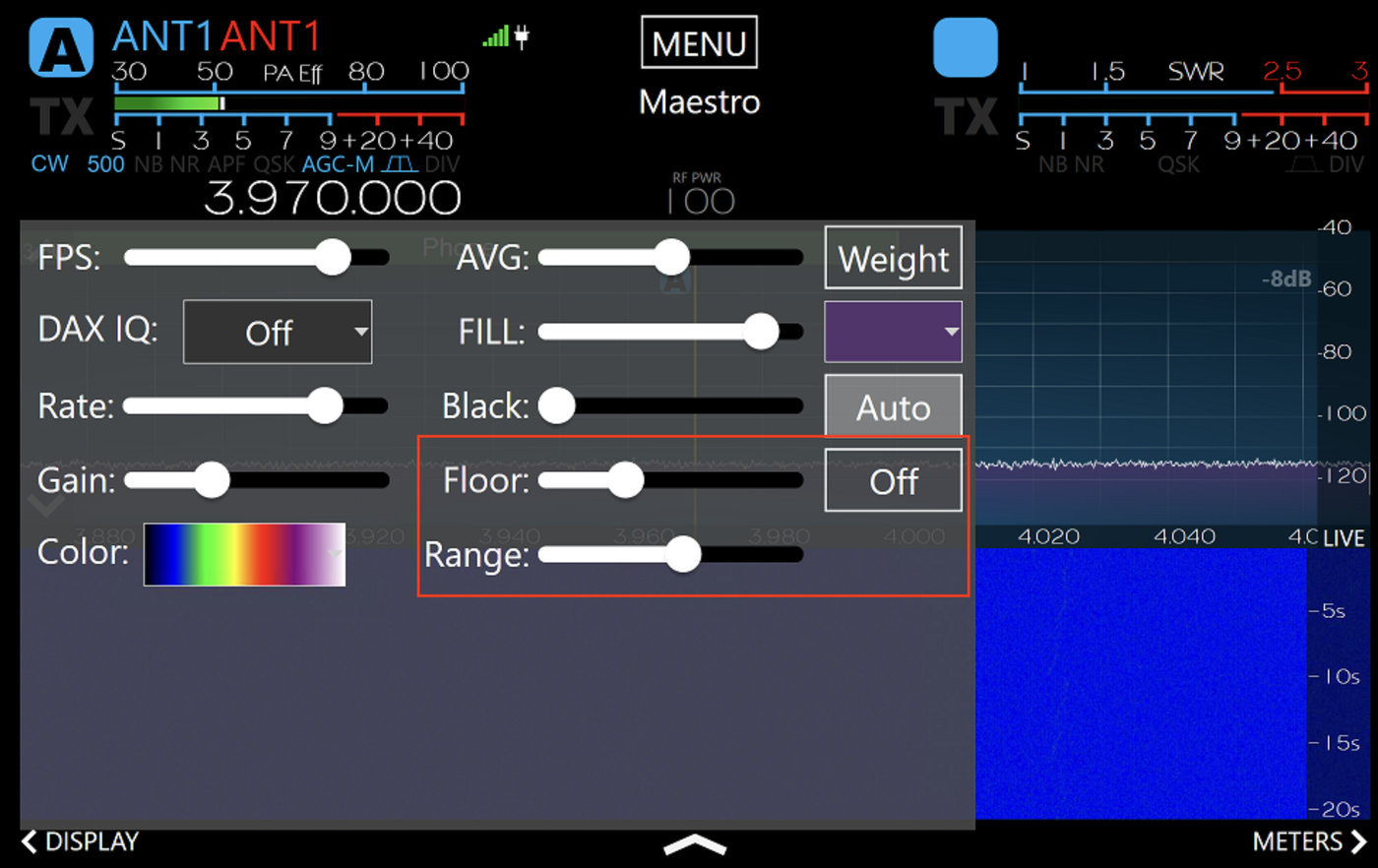

Setting Noise Floor Range in Maestro and M-Models
- Open the Display menu.
- Set the Floor slider to the noise floor position you want, then touch the button beside it to turn Relative Noise Floor Scaling on.
