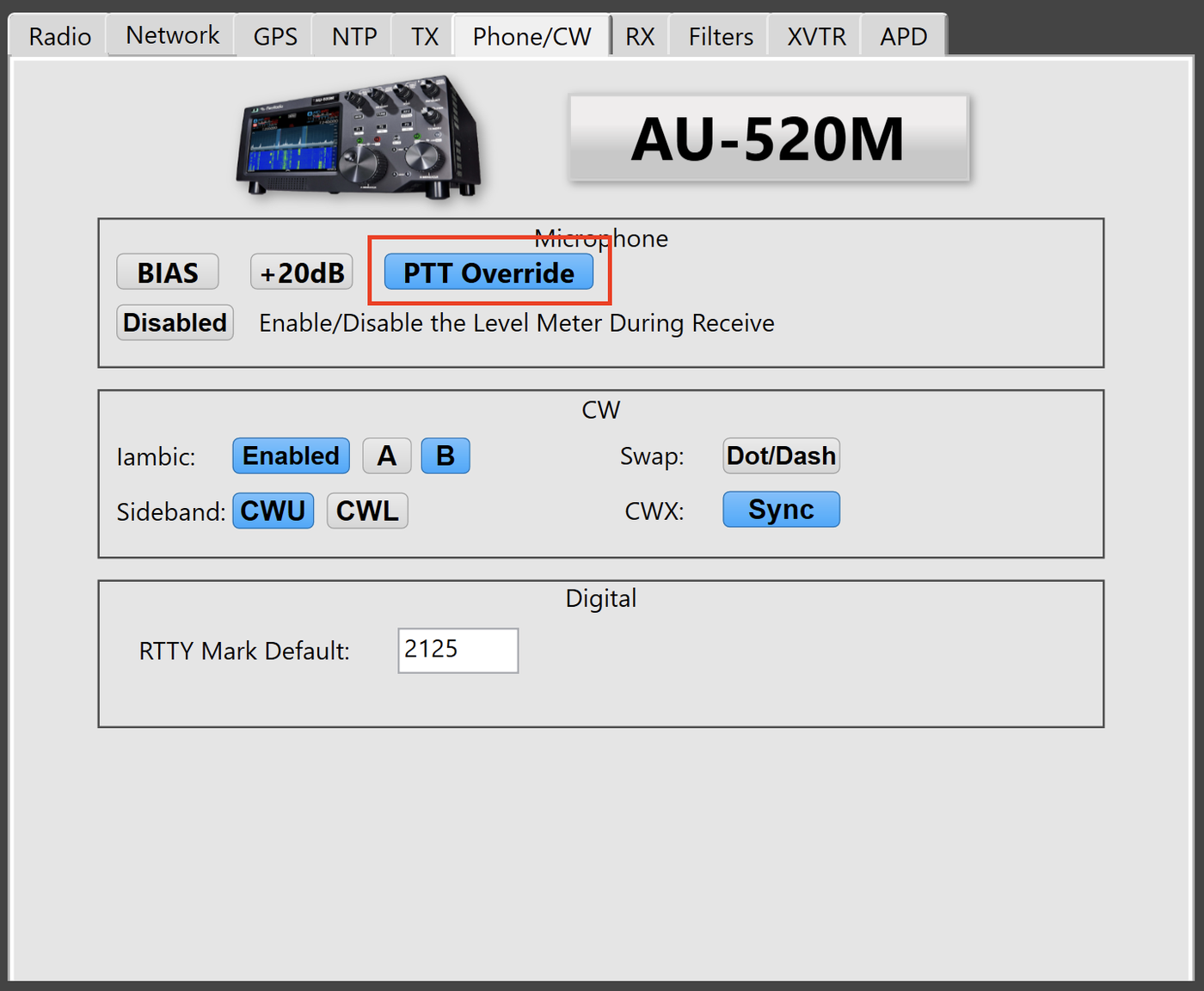

Setting PTT Override in SmartSDR for Windows
- Navigate to Settings > Radio Setup > Phone/CW.
- Select PTT Override to enable it. Clear it to disable.

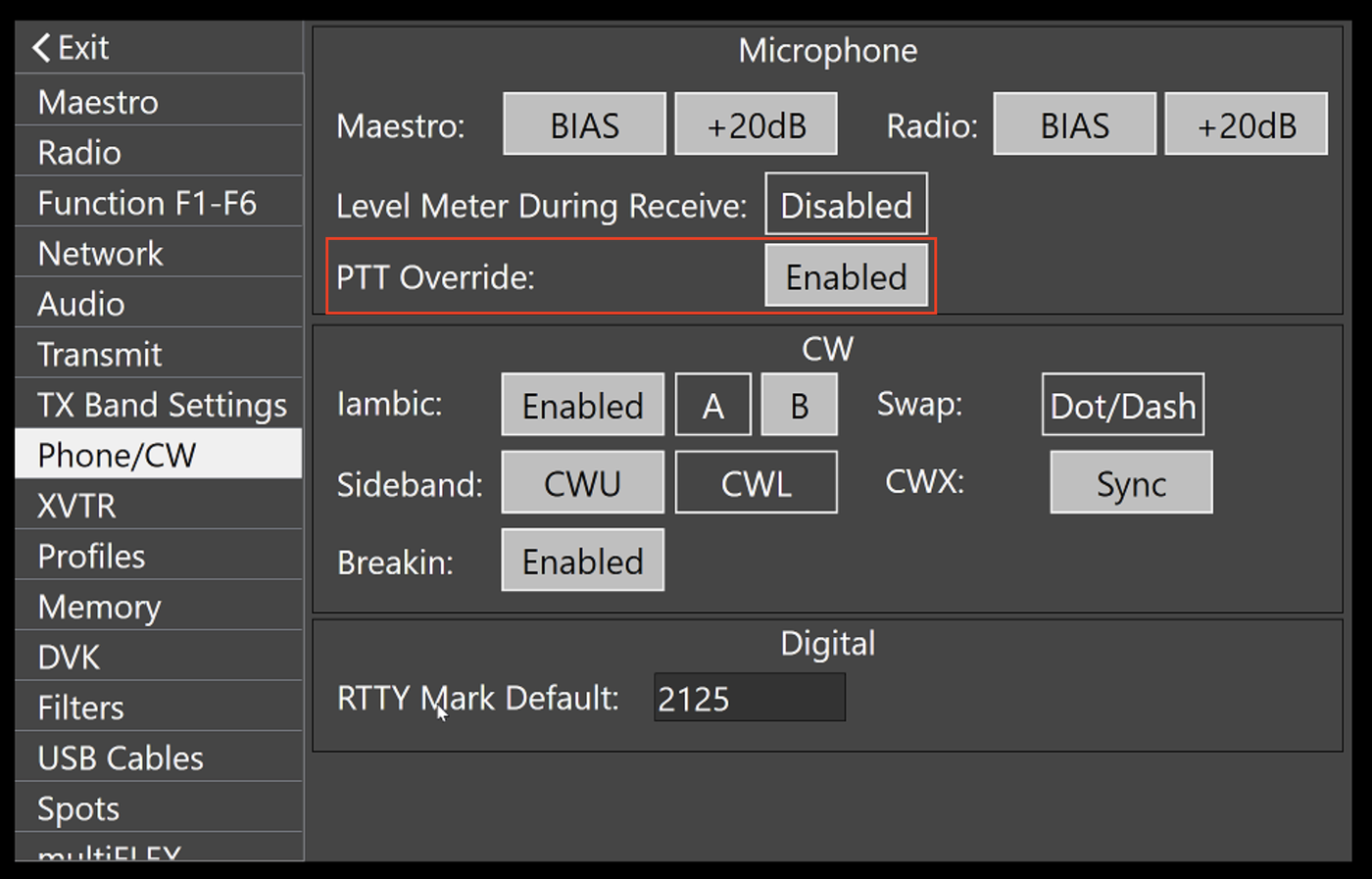

Setting PTT Override in Maestro and M-Models
- Navigate to Menu > Phone/CW.
- Set PTT Override to Enabled or Disabled.
