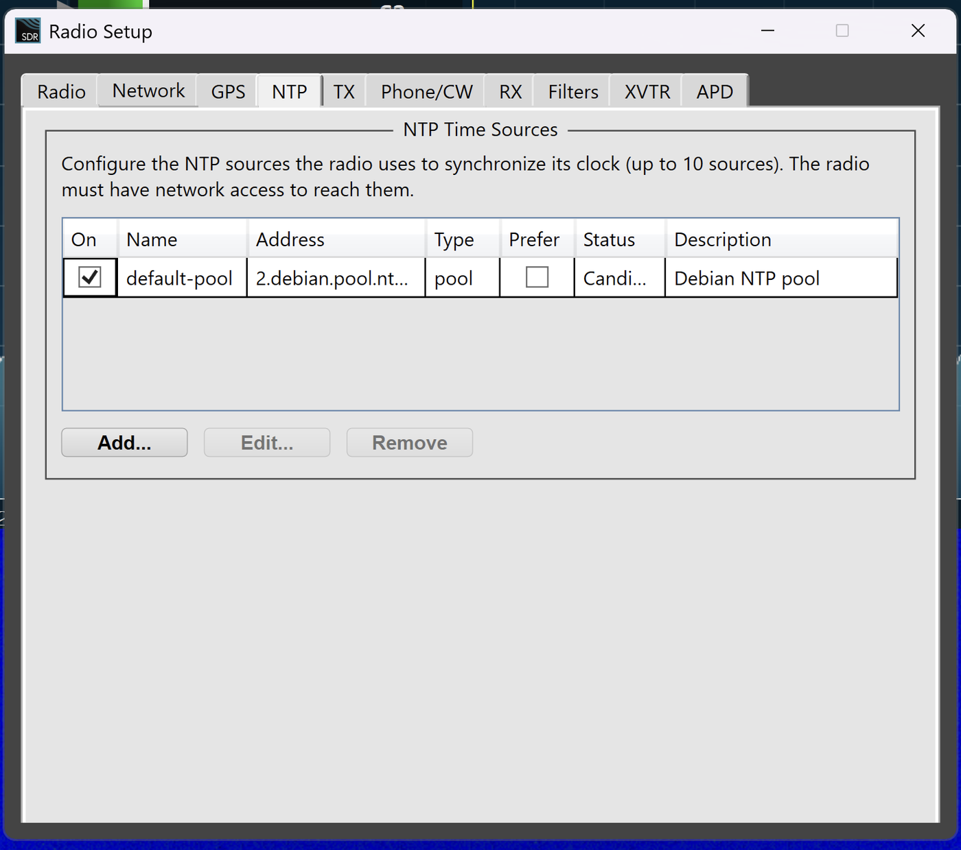

Viewing NTP Sources
- In SmartSDR for Windows, navigate to Settings > Radio Setup.
- Select the NTP tab.
The NTP Time Sources list shows each configured source:
| Column | Description |
| On | Enables and disables the source. A disabled source stays in the list but is not used for time. |
| Name | The name that identifies the source. Fixed when the source is created. |
| Address | The server, pool, or peer address. |
| Type | Server, pool, or peer. |
| Prefer | Marks the source as preferred. More than one source can be preferred. |
| Status | The radio’s current use of the source. See Status Values. |
| Description | The optional description you gave the source. |
Selecting a row shows a Selected source panel below the list with live detail:
| Field | Description |
| State | The same information as the Status column, in longer form. |
| Stratum | The source’s distance from a reference clock, as reported by the source. |
| Reachability | How many of the last eight polls got a response, for example, 8/8 (reachable). |
A dash in these fields means the radio has no current data for the source, normally because the source is disabled or was just added. The Status column is blank in the same situation.
Note: Status and the detail panel refresh on a 30-second cycle. A newly added source may show a blank Status, or read Unreachable, for a poll or two before it settles.

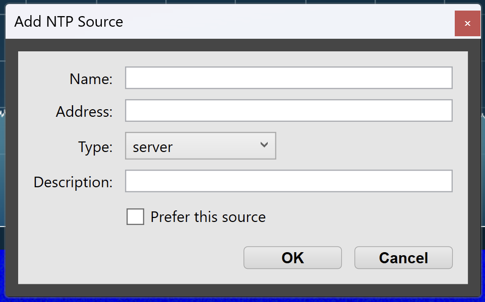

Adding an NTP Source
- On the NTP tab, click Add. The Add NTP Source dialog opens.
- Enter a Name (required). The name:
- May contain only letters, digits, and hyphens
- May not start or end with a hyphen
- May be up to 64 characters
- Must be unique on the radio and cannot be changed after the source is created
- Enter the Address (required): a hostname or IP address of up to 253 characters, using only letters, digits, and the characters

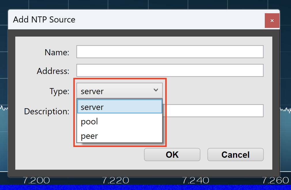

. : - _ %. - Select the Type:
- server — A single NTP server.
- pool — A DNS name that resolves to a set of servers, several of which the radio uses.
- peer — Another NTP peer, which exchanges time with the radio in both directions.
- (Optional) Enter a Description of up to 62 characters, using letters, digits, spaces, and the characters
. _ -. - (Optional) Select Prefer this source. The radio favors a preferred source over the others while it is reachable. If several sources are preferred, the radio favors whichever preferred sources are reachable.
- Click OK.

Status Values
| Status | Meaning |
| In Use | The radio’s clock is currently synchronized to this source. |
| Candidate | The source is usable and agrees with the others, but another source is in use. |
| Outlier | The source is reachable but disagrees with the majority, so it is not being used. |
| Falseticker | The source’s time is inconsistent with the others and is being rejected. |
| Jittery | The source is reachable but too unstable to use. |
| Not usable | The source cannot be selected, for example because it is itself unsynchronized. |
| Unreachable | None of the last eight polls got a response. |
| Disabled | The source is turned off in the On column. |
| (blank) | The radio has no data for the source yet. |
