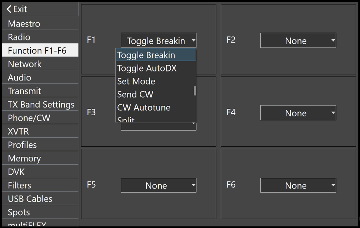

Assigning Toggle Breakin to an F-Key
- Navigate to Menu > Function F1-F6.
- Select the F-Key you want to assign.
- Select Toggle Breakin from the action list.
Using the F-Key
- Press the assigned F-Key to turn Breakin on or off.
- The F-Key LED is lit when Breakin is on.
