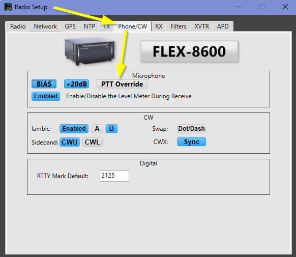

PTT When Using a PC or USB Microphone
The Hardware PTT does not function when using the PC Mic Input. (It defaults to the last "Hardware" Mic used with the PTT.) For PTT use when using the PC Mic Input, you will need to create a CAT PTT Port and use an adapter similar to the HaliKey plugged into your computer to send PTT signals to the radio:
